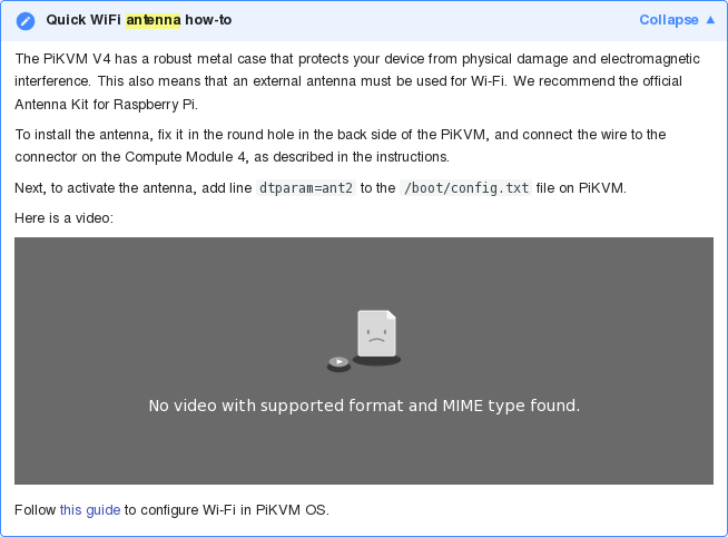

. If I go with the external antenna, I’m reading here :
To install the antenna, fix it in the round hole in the back side of the PiKVM
Uhm, I don’t see any round holes on any side of my device.
By-the-by, the video on antenna installation is broken:
We’ll check and fix the video, thank you for heads up.
On the V4 Plus datasheet take a look at the connectivity diagram, page 2. You want to use #17 - this is a special hole for the antenna. It’s covered by a plastic cap by default. There are two holes actually (if you want to use both WiFi and an optional LTE module, i.e. two antennas at once).
