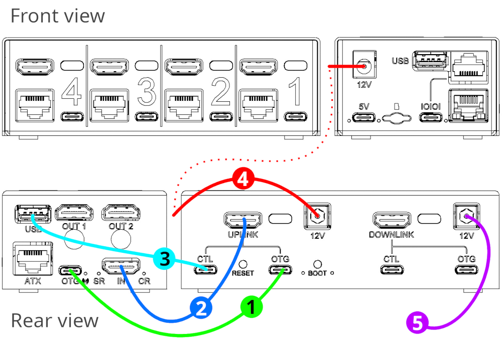

You can connect the 12V out on the V4 Plus to the 12V in on the Switch, so that you don’t need a splitter with two leads. Please see the diagram below – the daisy chain power connection is in red (#4).
