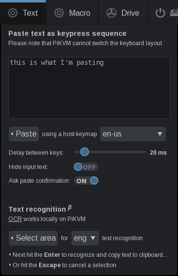

How do I paste into the PiKVM window “from the outside”? I have just found out the hard way that the clipboard inside the window is completely different from the one on the outside.
Hi AxelD,
In the PiKVM window you click on Text, and an input box will drop down:
Click on the text area right under Please note..., paste there [1], and press the * Paste button. This will send your local clipboard contents to the remote computer.

Wondeful, thank you so much!
