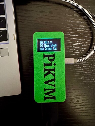

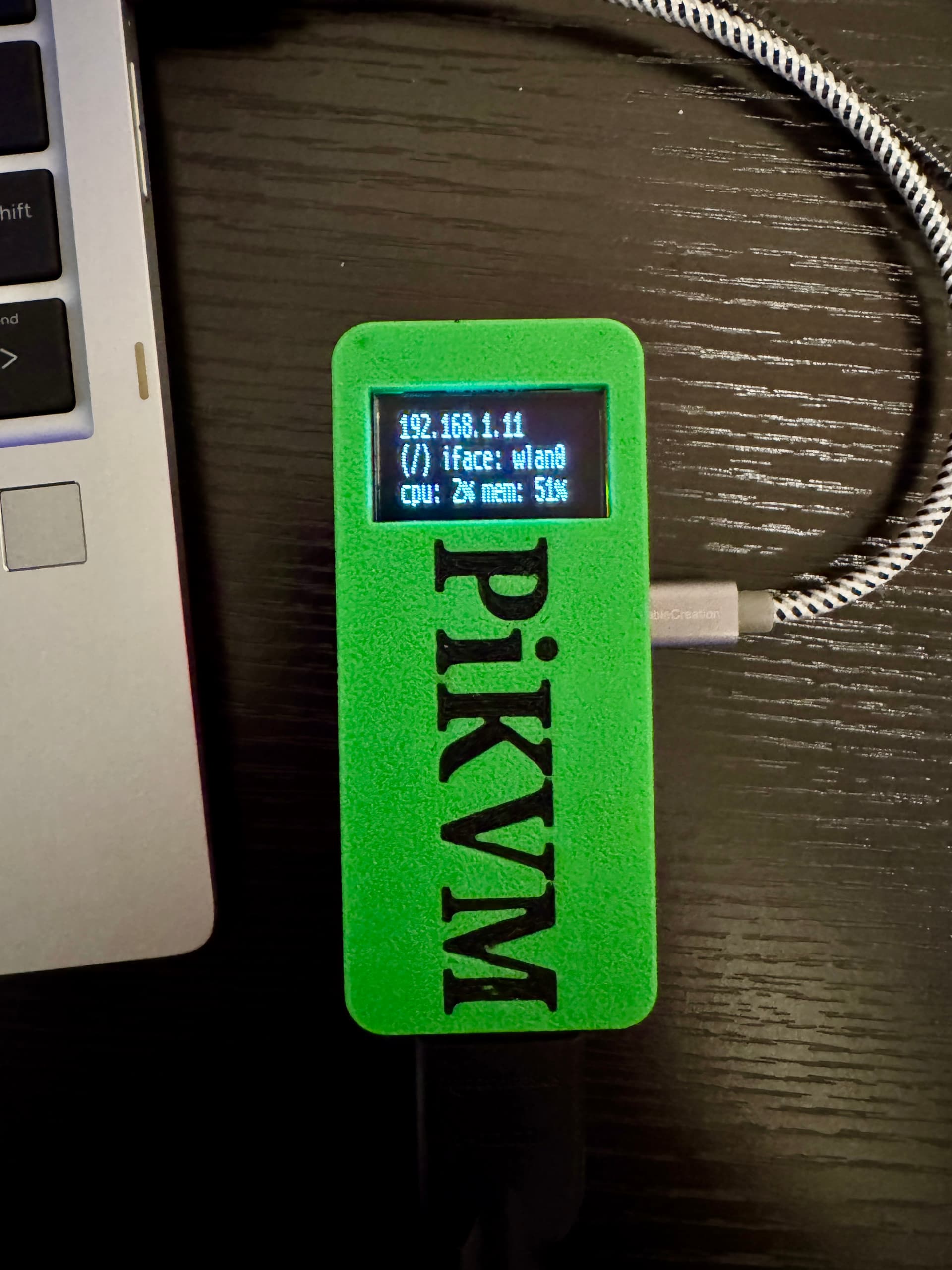

I got a new OLED in today. After successful testing on my breadboard Pi Zero, I thought I was in good shape. Turns out I had a bad OLED cable for my PiKVM setup too (the old OLED was also bad). I’ve added some pictures of my successful build in case anyone else wan’ts to add an OLED to their PiKVM v2 w/Zero 2 W.
Last, I modified a PiKVM case to add the OLED. I uploaded the model here: PiKVM v2 w/OLED on Zero 2 W by ramseyrt - Thingiverse
