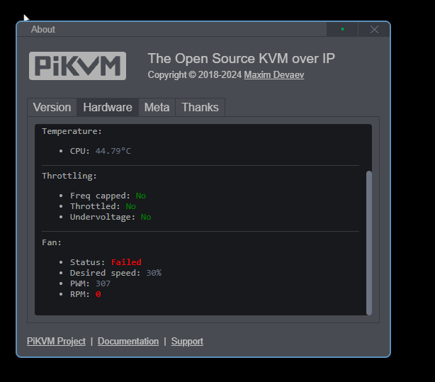

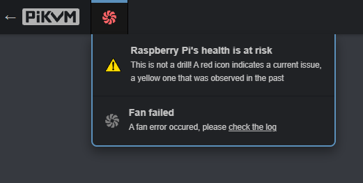

[2026-01-25 23:36:54 kvmd-fan.service] — – ERROR [11.492 loop] – !!! Fan is not spinning !!!
I don’t see any other log related to the fan, the led shows the pi running at 45.8 for temp.
Is this a hardware issue as I never see the fan trying to start? Any configs worth trying to update?

That definitely seems like an issue, have you fully updated the device using pikvm-update (recommended to do through SSH, but it can work through the web terminal).
If you unscrew the top and open the device, can you check whether the cable from the fan is plugged in or unplugged inside the case?
We’ve discovered the clip that holds the fan and fan shroud might have gotten dislodged in shipping and the fan itself had gotten unplugged (possibly from the clip pushing it off since it would be somewhat spring loaded).
