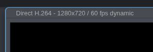

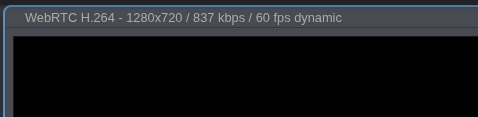

I have a PiKVM v3 pre-assembled connected to a HDMI to DisplayPort adapter (the video out is only DP). The pikvm v3 clearly thinks there is a video stream, however I only see a blank screen on both WebRTC and DirectH264 modes.
I plugged the HDMI cable into a monitor and see the console, as expected. I plugged a DP cable into monitor and see the console, as expected. Literally do not see the console in the pikvm KVM interface (see 2 screenshots which should show a “login:” prompt.
I’ve read through the FAQ and searched around for answers. I have tried forcing various resolutions as well as tried to research edid issues.
Is this some edid or something else going on? Any pointers to troubleshooting?
Thank you.
The same pikvm works fine on a system with native HDMI, so it’s not the pikvm. Something with resolution or edid is my best guess so far.
I’m only allowed 1 image per post, so here’s the Direct H264 screenshot showing the same thing,

Okay, good. What video timings does the monitor report from HDMI? resolution? frame rate?
