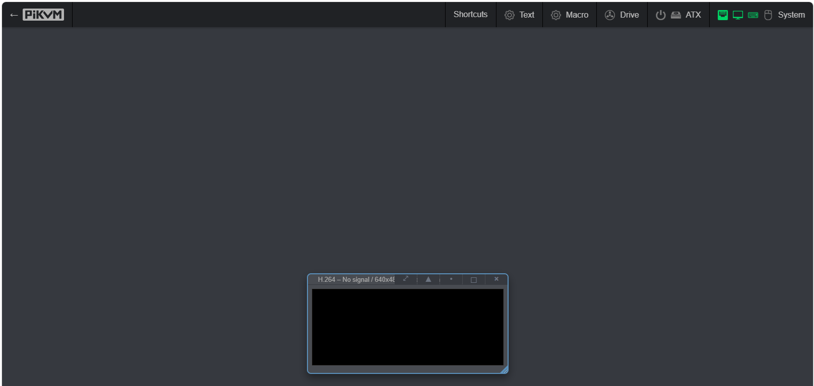

Black screen in KVM mode DP-> HDMI->PiKVM-Plus4
I am getting
Hardware:
  • PiKVM v4 Plus
  • Powered via 12V barrel jack
  • HDMI from server → PiKVM HDMI IN
  • Browser access
  • Computer side: it has only DP ports, so I am using DP to HDMI (female) → HDMI cable → PiKVM HDMI IN
Issue 1 — No HDMI Signal
The PiKVM interface shows:
  • “No signal”
  • 640×480
  • 0 fps
I confirmed the following:
  • The PiKVM is powered correctly via 12V
  • The Web UI loads normally
  • HDMI cable is connected to the PiKVM’s HDMI IN port
  • Server is powered on
  • PiKVM ATX controls are working
But the capture window always shows a black screen with no signal.
This is the first time I am using it. I just opened it today, ordered this device a year ago.
What could be the issue here?
HDMI and DP are both digital signals but they aren’t directly compatible. You need a DP++ port with a passive adapter or an active adapter, Visiontek makes some nice ones.
