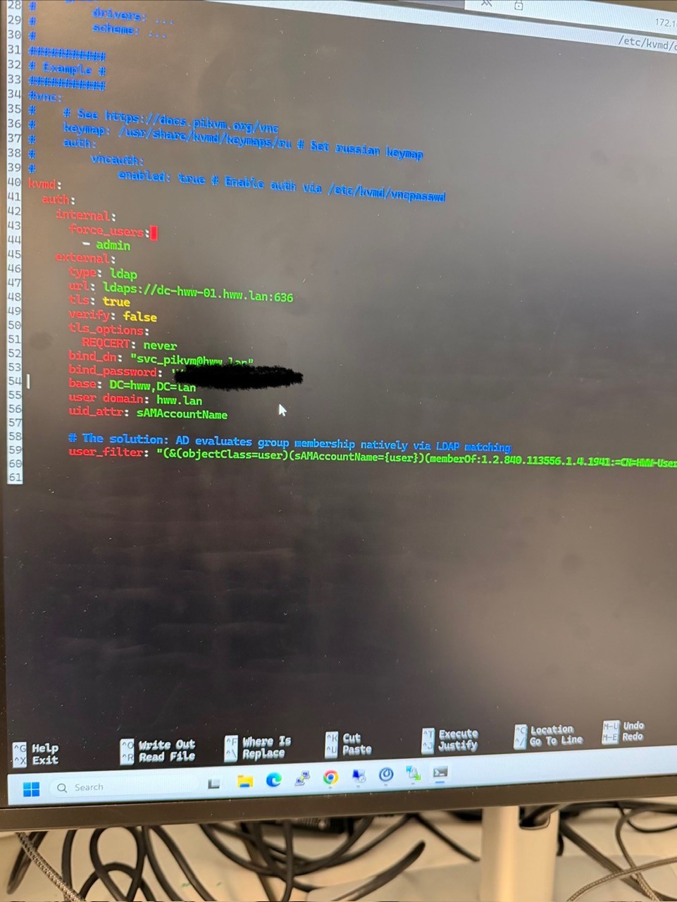

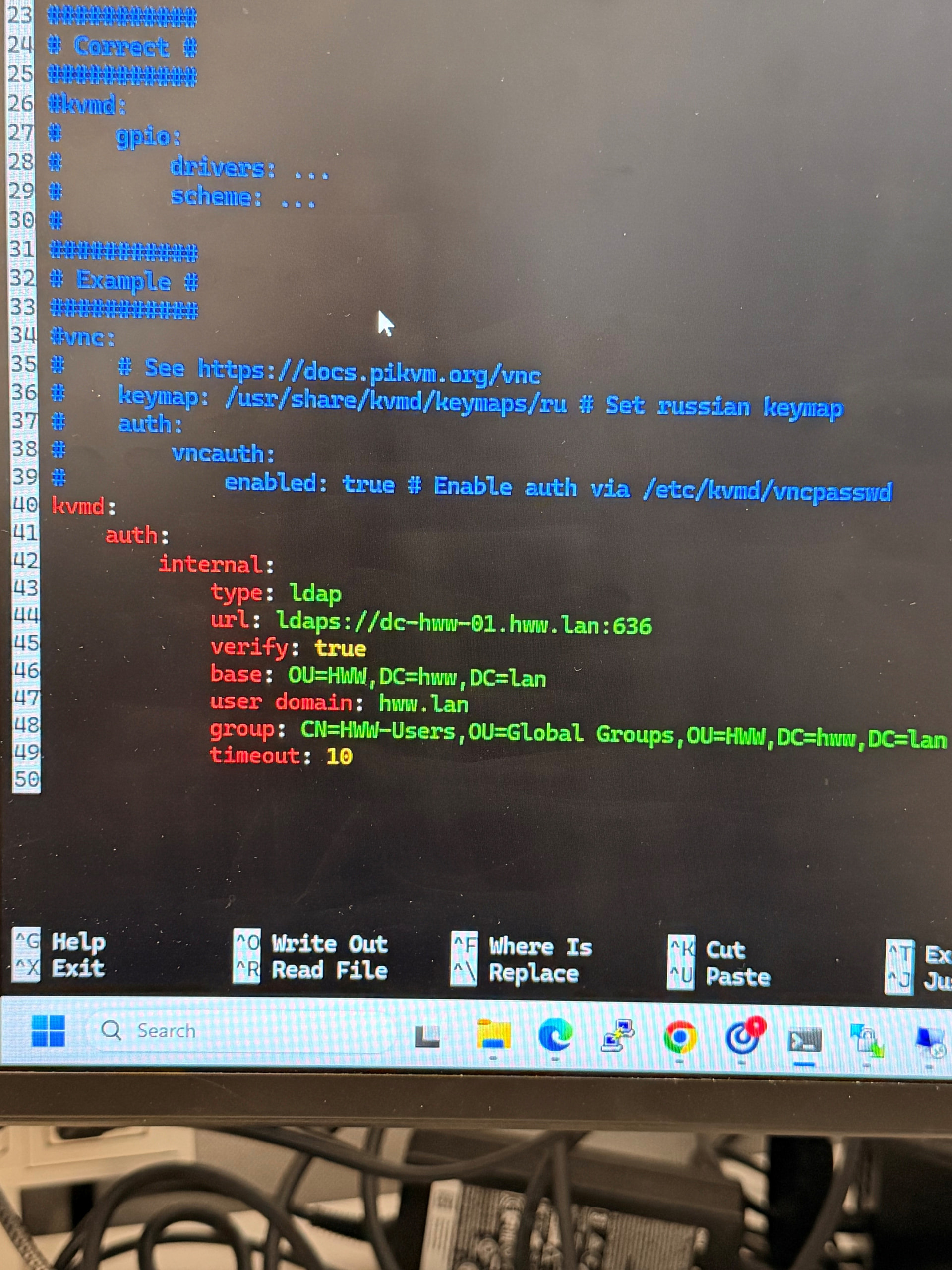

Hey perhaps someone here can help me out here. I have a pikvm V4 Plus that I am trying to get configured to authenticate via ldap and Active Directory. I have been messing with the overide.yaml config file but nothing has worked. I have tried for the past 2 days and keep getting an access denied error message through the GUI and logs. I am trying to have the Pikvm authenticate users against Active Directory. I created a service account for the pikvm, and made sure i called out the OU for all my users but it still does not work. Can someone look over my override.yaml file ( see picture)
and see if they see anything that stands out or a fix? Thanks
Hi @mramos17 – sorry for the slow reply, and sorry you’ve spent two days on this with nothing in the logs to work from. That second part isn’t your fault, and it’s the key to the whole thing, so let me start there.
PiKVM’s LDAP plugin reads exactly six settings and silently ignores everything else. (Unknown keys produce no error and no log line at all – that part is genuinely invisible. Authentication failures do log, though, and I’ll come back to that at the end.) The config loader walks its own list of known options and picks those out of your file – it never looks at the keys you actually wrote. So an option it doesn’t recognise isn’t reported as an error, it’s simply never read. Nothing is logged, because nothing in the code ever sees it.
The six it reads are:
url          verify          base
group        user_domain     timeout
Would you mind comparing your override.yaml against that list? Several of the settings in your screenshot don’t appear to be on it – and if that’s right, they’re being discarded silently, which would explain why changing them has had no effect for two days. Worth checking spelling carefully too: a key with a space where an underscore belongs is still valid YAML, so it loads cleanly and then does nothing.
I should be straight with you about how confident I am here. What I’m sure of is how the plugin behaves – that’s from the source and the docs. What I’m guessing is that it’s what’s biting you, and I’m guessing it from a photo, on a kvmd I don’t know the version of. So treat the above as a strong suspicion rather than a diagnosis, and let’s confirm it rather than assume it. Which brings me to the useful part.
There’s one structural thing I’d flag before you retry, because it changes your setup rather than just your syntax: PiKVM binds to AD as the user who is logging in, not as a service account. It builds username@user_domain and binds with the credentials the person typed at the prompt. There’s no service-account bind anywhere in the plugin – so the account you created for it isn’t being used, and user_domain has to be set or the bind goes out as a bare username, which AD will refuse. That failure looks exactly like what you’re describing.
One more that catches people with tidy AD: authorisation is a single, direct memberOf check against the one group you name – nested groups don’t work. If your users are members of a group that’s nested inside the group you’ve specified, they won’t authorize. They have to be direct members of that exact group DN.
The documentation for all of this is here, and it has a complete working example you can copy:
That page is easy to miss – the main authentication page only links to it in passing, which I suspect is how you ended up building the config by hand. We’ll look at making that signposting better.
Two more things that will cut this short.
I can’t see a group setting in your screenshot – it may simply be cropped, since the right-hand side is cut off. But if it’s genuinely absent, that alone would stop the block working: it has no usable default and an empty value fails validation. Same for user_domain, for the reason above.

Thank you so much for taking the time in writing out an explanation. One of the things that has me confused a bit is the group nesting. I do have a group field and i’m pointing it to a group under an OU called HWW>global groups> and then Users. Should I just point it to the HWW OU and get the DN for that OU?
Also I did try to use ONLY the five out of the 6 with (timeout not being used) and i still get the Got access denied for user ... from auth service 'ldap' error. We dont use 2FA either so i can keep it disabled. For the kvmd version i am running 4.213-1
@ewspikvm Hey, we are at a standstill, we tried to make sure our certificates were updated in the anchors directory. We have simplified our configuration and tried multiple group: groups and all of it keeps failing at login to the GUI. My coworker has helped me out and we have tried for weeks now to get it to work but nothing is working. We made sure that the pikvm can ping the DC, and that we were a member of the group we specify. Our KVMD version is 4.213-1 and the output that we got from 0 from the 2fa command. Also in the jounral command we got a ERROR— got access denied for user ‘xxx’ from auth service ‘ldap’
